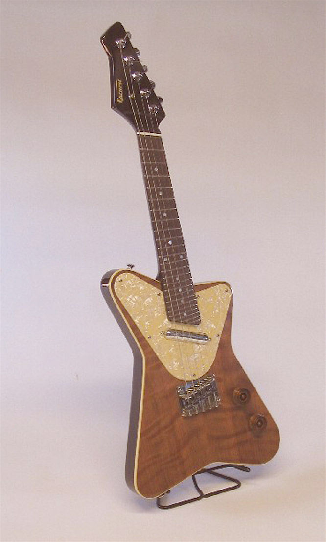

I play an Earnest 5-string electric mandolin with the Novax system, and love
it...
"Normal" five or ten-string mandolins don't seem to cut it on one string or
another, and this system seems to work fine to present all the strings in a
suitable scale length....
Love to see an acoustic 10-string with a Novax 'board....
